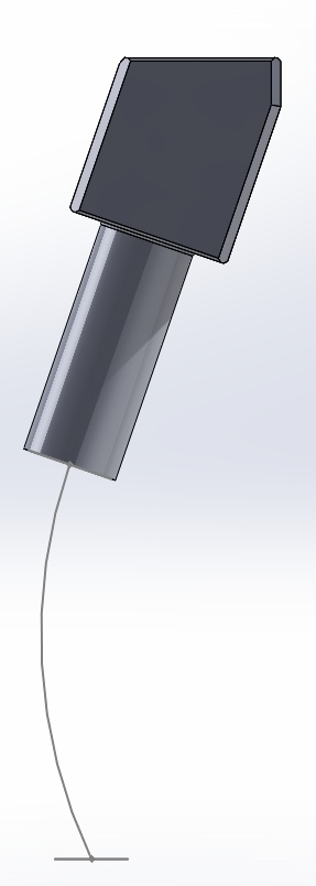

Hi, I'm currently trying to use the loft feature for this small test piece that would be similar to a real life counterpart.

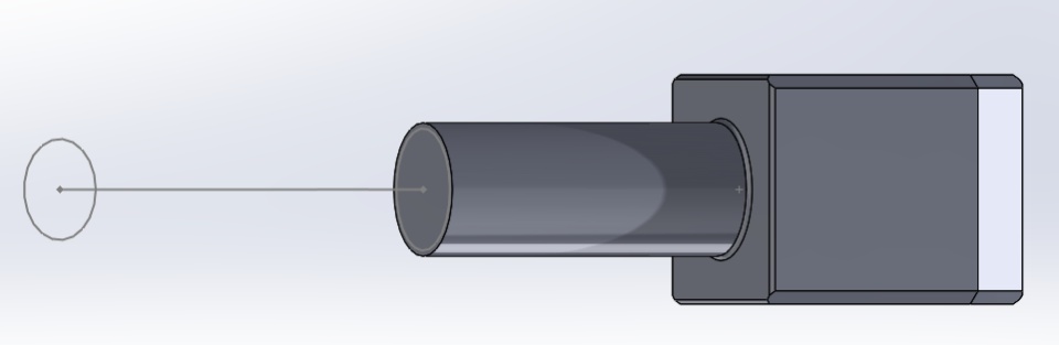

However I'm stuck in how to make the loft feature to work in this situation, as the sweep boss feature get me a result similar to what I'm looking for the "tail" of the piece, the thing is that the superior sketch visible and the inferior sketch visible have different circumferences and the "tail" feature should have the curvature shown with the guideline while the profile diminishes along the path.
Do you guys have any tips for this situations or could you instruct me in how to use the loft feature properly when using curved guidelines?
The file attached was saved in SW2017.
Thanks in advance.
