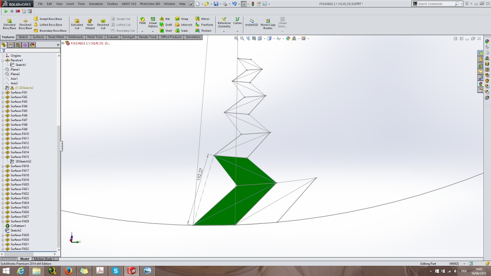

I would like to  know if there is a way to linear pattern, rotate and scale at the same time either lines in a sketch or surfaces in a part ?
The scale factor is known.
I tried to use the "Instance to vary" option, in the Linear Pattern tool but it is grayed out when I select the bodies....
Here in green are the four triangles I want to duplicate as shown in the sketch.
