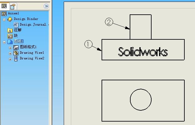

How to inserting auto balloons into a drawing (with API).
To set detailing properties:
  1.   Click Options on the Standard toolbar, or click Tools, Options
  2. On the Document Properties tab, click Detailing.
  3. Select from the options described below, then click OK
I hope with API,  inserting auto balloons into a drawing.
https://forum.solidworks.com/message/142919#142919 is code
