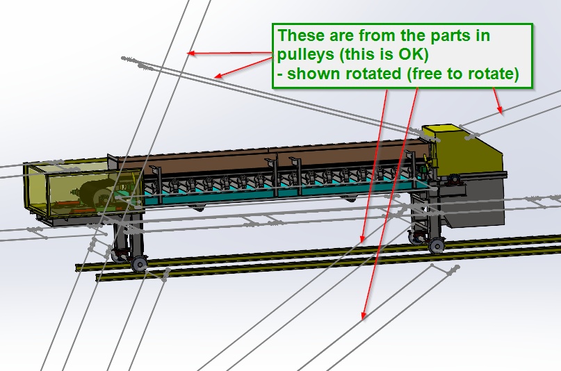

Down the road, I found each and every derived part has all the sketches coming from the derived part
I noticed this because of the rotating parts of which those sketches from the derived parts are at rotated positions.
Please see the image below:
6. Each and every derived part occurrence was containing all the sketches in the master sketch. It was so many.
I hid each sketch of the derived part occurrence from within assembly. It is OK, because I learned what to do next time.

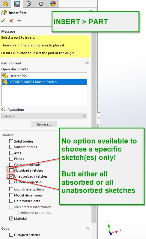

  • I had to insert only the required sketch to create the derived part. But, from within INSERT > PART dialog box, no option is available.
        QUESTION: Is it possibly to insert only the required sketch(es)? I appreciate someone letting me know.
