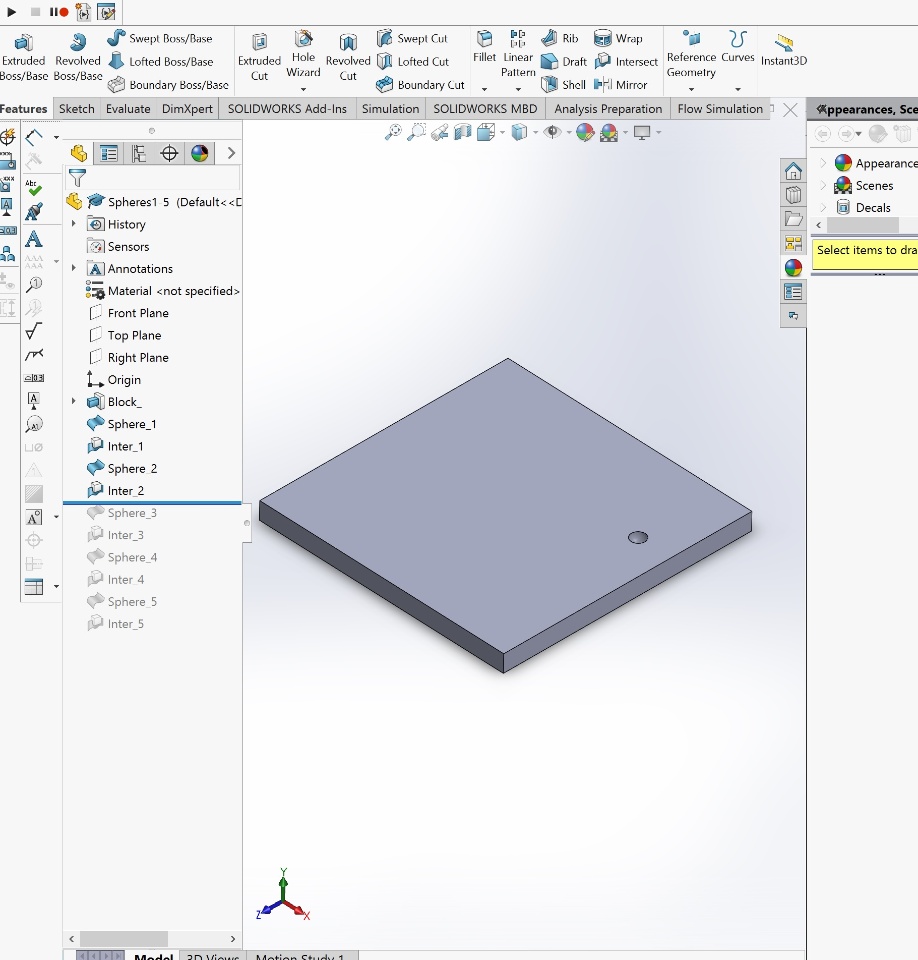

How to indentify and select region from PostIntersect2 feature to exclude it, in vba code ?
How to indentify and select region from PostIntersect2 feature to exclude it, in vba code ? I am trying to cut out multiple random size random distribution spheres out of solid rectangular body. The rectangular body is sometimes as region 1 sometimes at region 2. How is the feature assigning the regions ? What inputs/outputs are there in preintersect and postintersect features. I know its an array of bodies as boolean ( to exclude ) how to distinguish them one from another ?
I thought it was depending on the number of regions created so i did :
