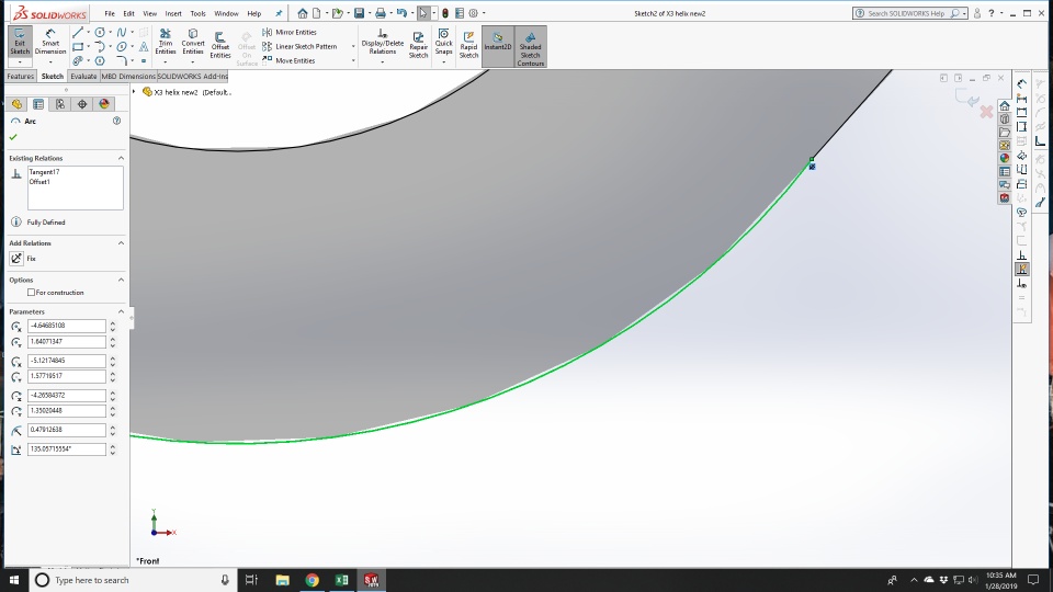

I am trying to cut this arc (green line) on a CNC but when we generate the code in MasterCam its commanding the cut in several straight lines (tangents shown in grey) to form the arc- the code is generated this way because SolidWorks is making the arc this way. This is ok but we need to smooth out the arc alot by substantially increasing the number of straight lines and decrease their length so the CNC code commands to cut a smoother arc. Ive made the arc out of a spline and its still the same. Another cylindrical part i made to test also shows the same type of tangents so it must be in the SW settings. Running SW 2019 full functionality

First if its an arc, MasterCAM should not make it tangent segment.
Second, MasterCAM has full control on how many segments to create. Not SolidWorks.

If you are trying to program this off the solid, I think you are going to get an approximation because it isn't an arc on the solid. Note that if you query the edge, you get an arc length but not a radius- because it isn't a circular element and there is no radius for MC to calculate from. So you are getting a line/arc approximation, and there is no tangency limitation in the toolpath calculation. You might get better results if you up your cut calculation tolerance, but I don't think you will ever get a single arc from this.
Since you have the sketch geometry available that generated the wrap, I would think using the sketch geometry and an axis substitution method will get you closer to what you want.

sorry for the delay but weve been troubleshooting this with Dassault and Mastercam- nobody can figure it out which is shocking. heres the files and photos of what we get. you can see the lines which is exactly what mastercam sees from the solidworks files.
This is a Z/C cut and has no y moves. Just a Y offset for the follower roller diameter so the center of the roller is on centerline.
Heres the toolpath mastercam is creating off our SW file. were commanding a spline or arc but only can get lines.
weve tried wrap and surface offset with no change Heres a link to the files if anybody would like to try. https://www.dropbox.com/sh/emv0a66hgcpx0ek/AACJsPaX3wbdbqIZfyuPbFIHa?dl=0 please help!!

Have you tried cutting your arc directly into a flat and checking the toolpath? When you wrapped it onto a cylinder, you increased the geometric complexity exponentially. It's not an arc anymore.

Those line are graphic only.
It doesn't affect model or finish part.
FL
FL 2021-04-09
You did draw an arc to cut the slot.
Once its cut, it become spline.
It depends on setting in MasterCAM on how to cut that profile.

I dont need a tangent at all, just need a true solid body arc. To make that arc i used the 3 point arc tool. Then offset a identical line to the inside and boxed it in to make a "slot" for the tool to cut. When i boxed it in to make the slot thats when SW automatically added the grey area as you see it. I made the same slot except i replaced the 3 point arc with a spline and got the same grey area result.

thats what we thought. originally we assumed it was MC doing the segments but after investigating it we found when we turned the arc into a solid part in SW it made the straight segments which mastercam follows exactly.
Just make a solid cylinder real quick then zoom in alot on the circle. you should see these lines. if not then its a setting i have incorrect.
KW
KW 2021-04-09
CNC is actually cutting the arc in straight segments. Weve tried to adjust this in MasterCam but the ST file i export out of SW for this model has straight lines in it as shown in the grey when it comes into Mastercam. Since the SW grey line looks exactly like the CNC cut we are assuming its in SW settings somewhere or i selected the wrong type of feature to make the arc.

Is the CNC actually cutting the arc in straight segments or does it just look like it does when you simulate the toolpath?
Sometimes increasing image quality will get rid of the choppiness in the toolpath simulation preview
