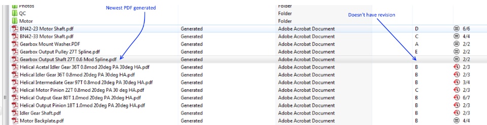

Hi All,
Using the Convert task to generate PDFs of a drawing once it is Approved.
How to make that PDF have the same revision as the drawing does?
Our system used to do that, but something has changed.
Attachment shows the new PDFs not having the revision while the old PDFs did
