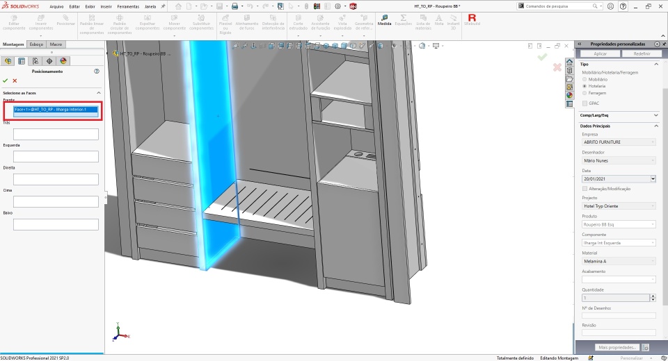

I would like to know how I have the value of the selectionbox in the module.

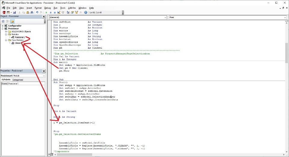

I tried unsuccessfully, even within the class to no avail. but what I wanted was to obtain a value within the module.
I need help.
Dim i As String
i = pm_Selection.ItemText(-1)
A = pm_Selection.GetSelectedItems(0)
(classe1)
Dim pm_Selection As PropertyManagerPageSelectionbox
Set pm_Selection = pm_Group.AddControl2(SelectionID, controlType, caption, alignment, options, tip)
Dim filters(0) As Long
filters(0) = swSelFACES
pm_Selection.SingleEntityOnly = True
pm_Selection.AllowMultipleSelectOfSameEntity = True
pm_Selection.Height = 20
pm_Selection.SetSelectionFilters filters
