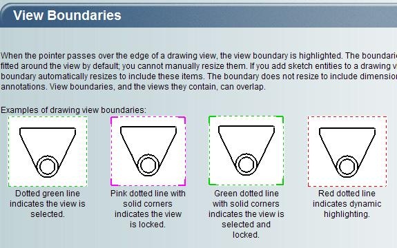

When the pointer passes over the edge of a drawing view, the view boundary is highlighted. The boundaries are tightly fitted around the view by default; you cannot manually resize them. If you add sketch entities to a drawing view, the boundary automatically resizes to include these items. The boundary does not resize to include dimensions or annotations. View boundaries, and the views they contain, can overlap.
Examples of drawing view boundaries:
