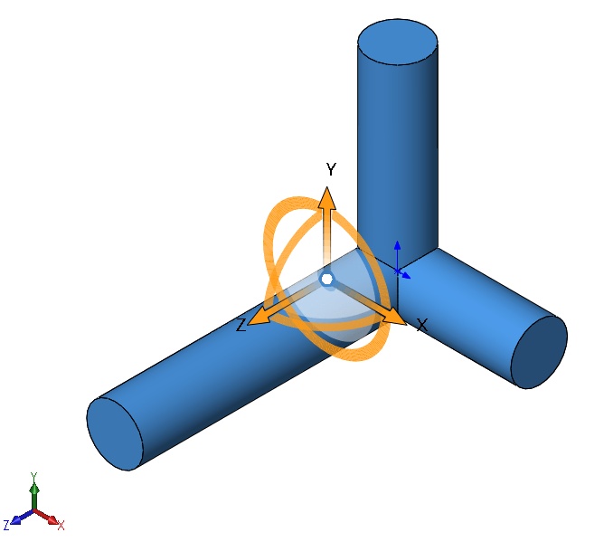

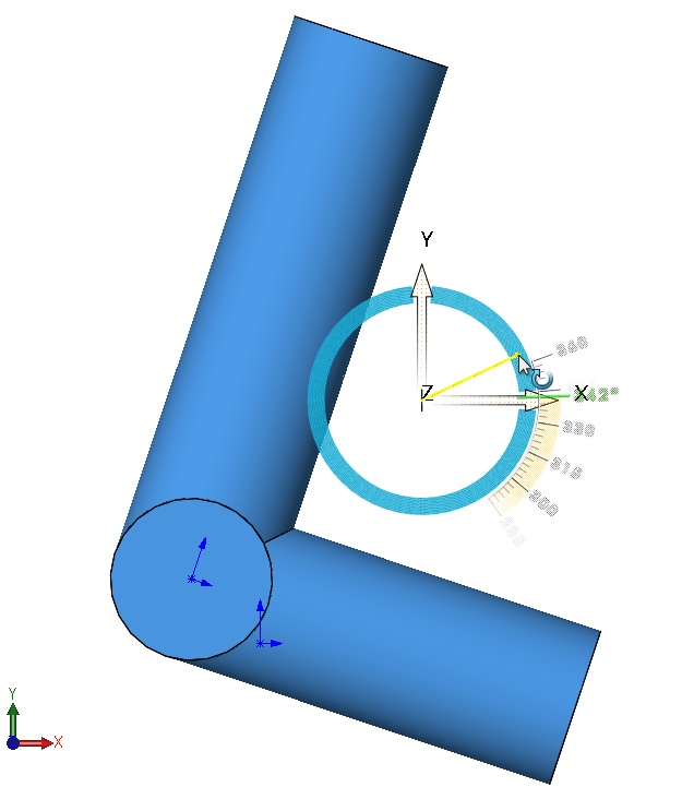

I use a part to rotate 200 degree in clockwise direction about Z axis.(see Fig2)
Use the following code to get orientation.
However,when the angle exceeds -180 degree, the angle I get is 160 degree rather than -200 degree.
It seems that solidworks changes direction automatically to calculate orientation when exceeding -180 degree or 180 degree.
How could I do if I want to get -200 degree information from the transform matrix?
