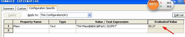

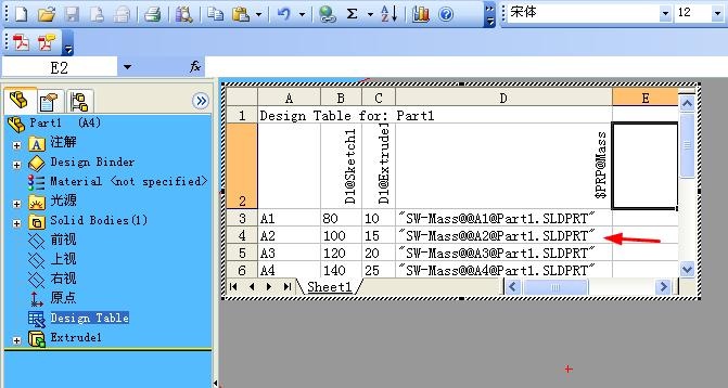

How to get mass in design table?
Use code →
"SW-Mass@@A1@Part1.SLDPRT"
Help me , Need \\\$PRP@Mass → result in excel
the code is

        swCustProp.Add2 "Mass", 30, "MyValue"
        Str = "SW-Mass@@" & sConfigName & "@" & swModel.GetTitle
        'Debug.Print """" & Str & """"
        swCustProp.Set "Mass", Chr(34) & Str & Chr(34)
    Next i
End Sub
