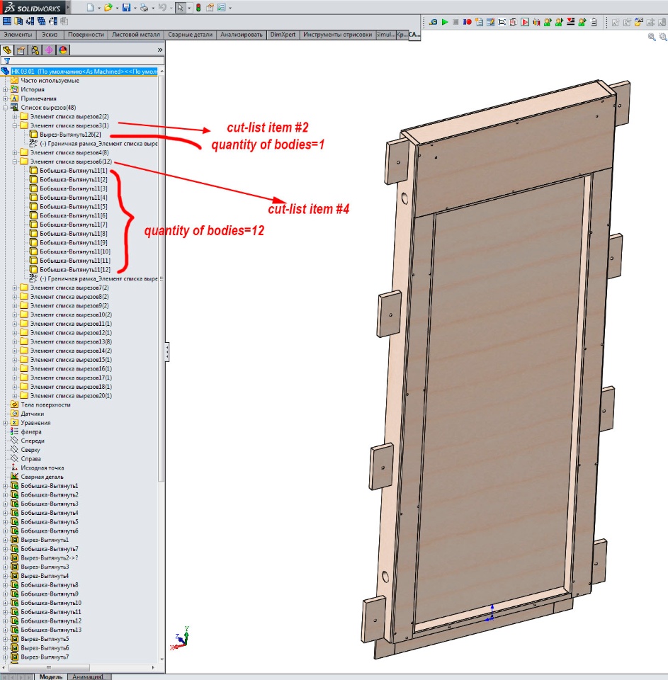

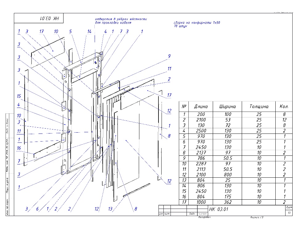

I have the welded  multibody part. I made the drawing and want to get the number of cut-list items in part in view. As you can see different cut-list items can contain as one body and several bodies.
I can get the number of bodies with command swView.GetBodiesCount.
But I want to find the count of unique bodies(i.e. items). In my case this count =17.
