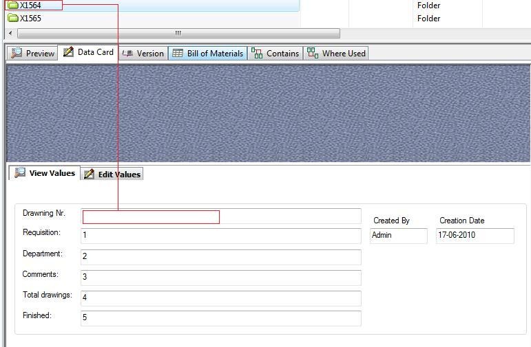

Hello everyone.
I know it is possible to get the filename (with or without extensions) automatic one your datacards:
But when it gets to foldernames the story is quite different:
I can't figure out the "string" to write or get anywhere in EPDM to get the foldername on my datacard, or can my VAR!
Any help will be highly appreciated
