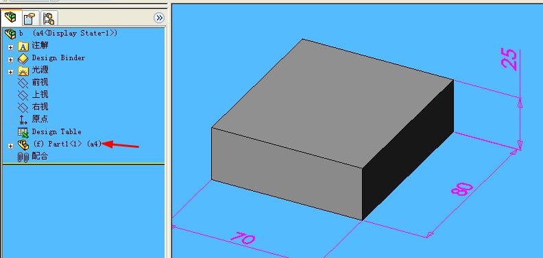

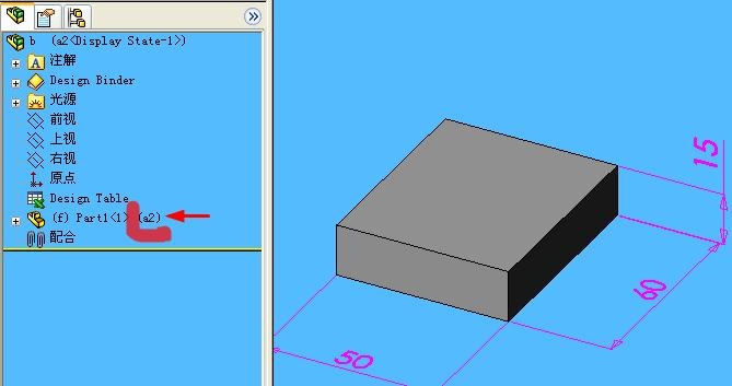

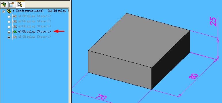

How to get feature name (Configuration)?
Sub main()
    Dim swApp                                   As SldWorks.SldWorks
    Dim SwModel                                 As SldWorks.ModelDoc2
    Dim SwFeat                                  As SldWorks.Feature
    Set SwModel = swApp.ActiveDoc
    'Debug.Print "File = " & swModel.GetPathName
    Set SwFeat = SwModel.FirstFeature
    Do While Not SwFeat Is Nothing
      With SwFeat
        If .GetTypeName = "Reference" Then
          Debug.Print .Name, .GetTypeName
        End If
        Set SwFeat = SwFeat.GetNextFeature
      End With
    Loop
End Sub
code result is Part1-1
help me , need result is Part-1→ (a2) (a4)  Configuration name
Sub main()
Set Part = swApp.ActiveDoc
Set SelMgr = Part.SelectionManager
boolstatus = Part.Extension.SelectByID2("Part1-1@b", "COMPONENT", 0, 0, 0, False, 0, Nothing, 0)
Part.CompConfigProperties4 2, 0, True, True, "a4", False
Part.ClearSelection2 True
End Sub
