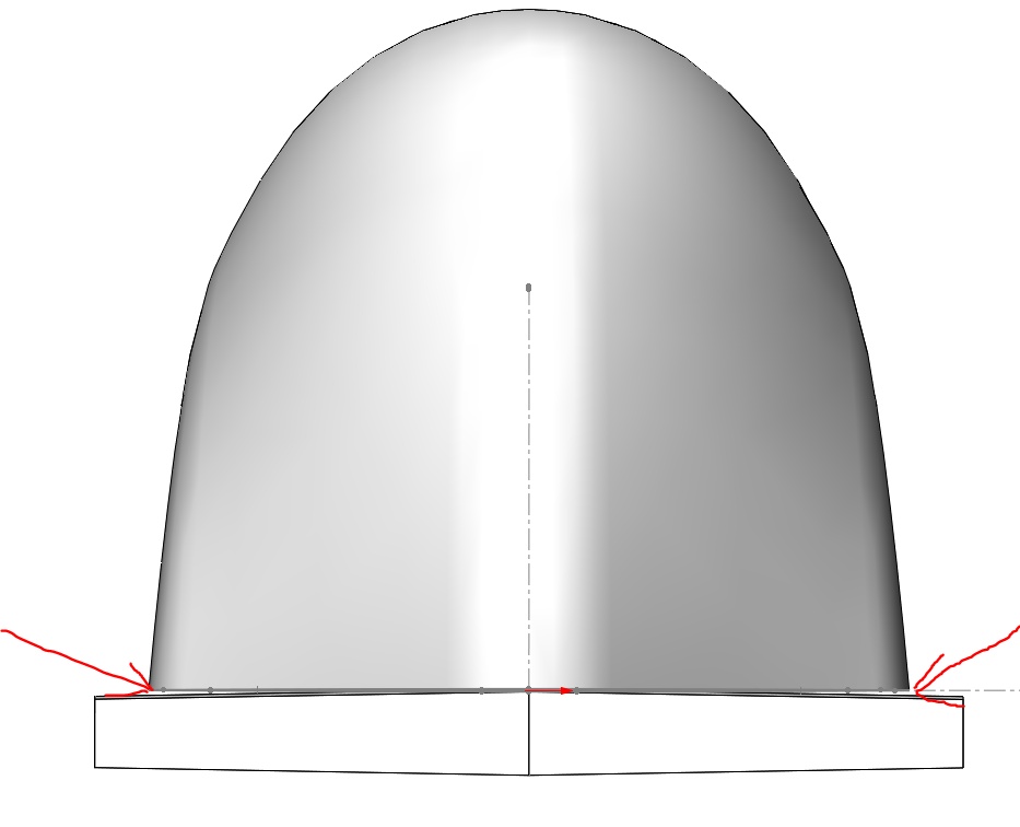

This piece will be cast in aluminum. Therefore, I am having to design with mold making in mind. The top piece was created using a thin loft. The end of the loft sits on my top plane:
The base had to be designed with loft from the center out. Now I want to take the end of my loft and extrude it down to meet the top of the base. I believe there used to be a command that would just let me grad the "surface" and tell it to "connect" to the other surface (not to be confused with surfacing tools - I am talking about extending the boss to the base)...
How did I do this before? OR...how can I do it now?

Extrude up to Surface is what you want... or you could bury the loft sketch in the square plate.

you can use combine, or intersect under features to force the voids to fill. otherwise just click the end face of your loft, start a new sketch, convert the profile, and extrude up to body selecting the desired target

Perhaps Replace Face.

I ended up just recreating the profile on the top plane and then extruding that to the body - I just wanted to be able to do that without having to create a new sketch. One time, and I swear I don't remember how I did it....I was able to just grab the face and tell it to extend.
I tried using combine and intersect - neither worked.
I knew I could go in make it happen using a new sketch - I just wanted to save some time.

(insert>face>move )would be the only way to do that. unless you have instant 3D checked, then you can just pick a face and drag it out to the desired position.

Did you try move face with translate step up to surface end condition?

Kevin,.. I'll attach what I think you are trying to do..

Move face

By looking at the inside section, I can tell that is exactly what I am trying to do - but how did you do it?

If you have the top section with around shape and bottom section with square
Paul's model show the nice transition between them - see below image - but it might get an issue with casting this part - see blue mark
