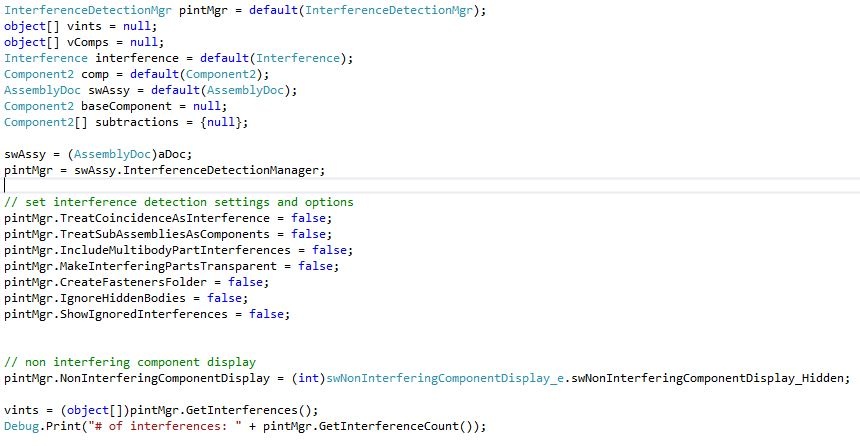

How to exclude components from interference detection
When I manually do an interference detection I have the option to exclude components.  How can I do this in c#?
SolidworksApi macros
