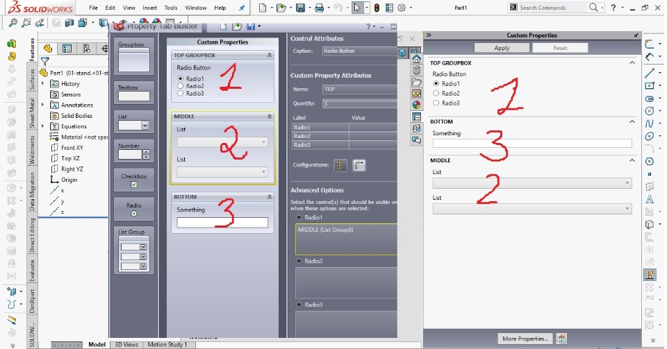

So, with 2016 version custom property tab builder got renewed. One of the news is list group. I can not figure out the following:
1. I want to have several groupboxes, simply put:
TOP: Radio buttons
MIDDLE: One of two "List groups" , depending on which radiobutton is selected on top
BOTTOM: Just another Groupbox with a Textbox / Listbox
The problem: I sort it as described in tab builder, but despite of that I get the "List group" at bottom in Solidworks window (MIDDLE is inversed with BOTTOM, and Listgroup gets at the lowest position). I can't find a cause or solution. Do you experience this also? Screenshot attached:
I read in this forum that some issues of tab builder innovations from 2016 version will be fixed in 2017 SP2. If you have already upgraded, may I ask you to test this dummy CP file, if this also gets inverted? I am still on 2016, CP template is attached.
