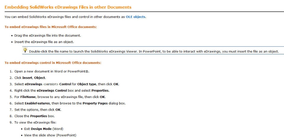

Has anyone come up with a fool-proof method of embedding eDrawings into a PowerPoint or Word document?  I've checked the help, but it appears to be for earlier versions of Office (http://help.solidworks.com/2010/English/edrawings/topics/Embed.htm).  I've also searched the fora with no love.
Here's what I've come up with that kinda sorta works in Office 2010:
1.  Go to Options and show the Developer Tab.
2.  Click the Macro Security button and select Enable Macros.
3.  Click the More Controls button and select eDrawings 20xx Control.
4.  Draw the box for the control object.
5.  Right click and select Properties.
6.  Select FileName and browse to the file.
7.  Select EnableFeatures and select the features you want to see in the control box.
8.  In Word you have to exit Design Mode and in PowerPoint you have to view the slideshow to see the eDrawing in all of its glory.
