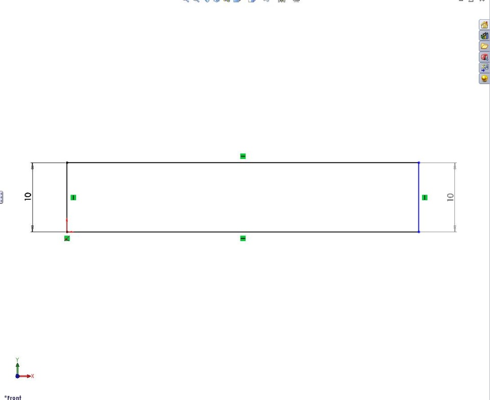

How to determine the dimension belong to which body?
I have created four segments to make a closed section.
Forthemore, to add the dimension by the following functions "ModelDoc2::AddDimension2" and "Dimension::SetSystemValue3".
Then, the result goes as following picture,

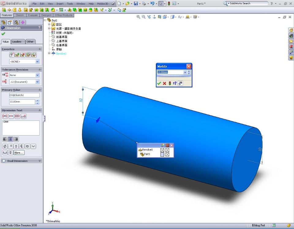

Moreover, I use the API function "FeatureRevolve" to make a cylinder as follows.
I can catch the event about the dimension being changed from the function "swPartDimensionChangeNotify".
My question is that is any possible to query this body (ex:revolve 1) from the select dimension ?
By the way, I use C++ Com as my development tool.
