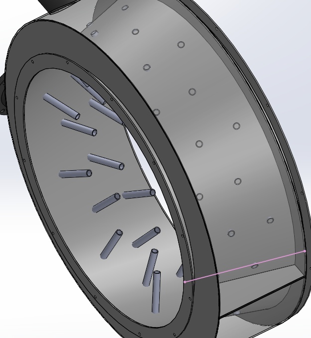

I am trying to figure out how to create a flat pattern dxf for the rolled cone in the below picture, which includes holes for each of the short pipes as shown. The closest I have come is doing a split line and selecting the outside pipe face, but when I unroll the cone the split faces are merged back into one big face. Split only seems to work with multi body (this is parts only).
Is there a way to accomplish this?
