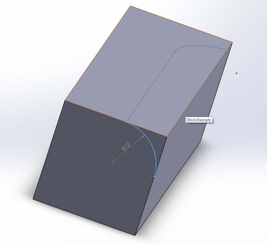

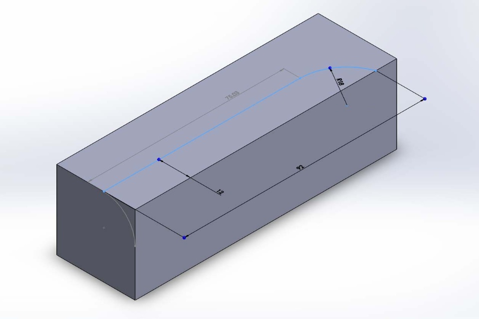

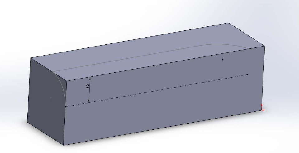

It's pretty hard for me to explain, so I'll start by posting some photos of an example part I made to show this problem.
Image Example: SIDE
Image Example: FRONT
Image Example: TOP
So we have three parts here: TOP, SIDE, FRONT.
These are images of a 30x30mm by 100mm long rectangle. (Correct me if I stated the dimensions in a incorrect manner please.)
On the TOP example, you see a top sketch of 92mm long with a curve towards the end. It is 12mm from the edge.
On the FRONT example, you see a sketch. This is the sketch I want to chip off the block.
To state another way, we have this rectangle, and I want to round the edge. The FRONT sketch shows the dimensions of the "rounding".
On the SIDE example, you see a construction line showing how far down I want the "rounding" to go down. The SIDE example was made INCORRECTLY, I meant to make it mirror the TOP example. <-- As the TOP example curves in and the distance shortens; the side will also curve up so both distances from the edge will be equal.
I now want to use my "rounding" sketch to make an "fillet" of 12mm radius. The fillet will stay 12mm by 12mm till it reaches the curves at the end of the sketch and it will shrink it proportions but keep the same radius.

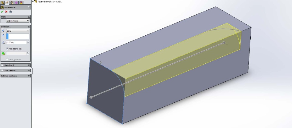

Here is a picture of where I'm stuck at:
I'm sure I'm using a incorrect tool here, but this is cut extrude.
I'm stuck, and i've searched a couple tools already.
I would love to get some ideas. Thank you very much in advance!
