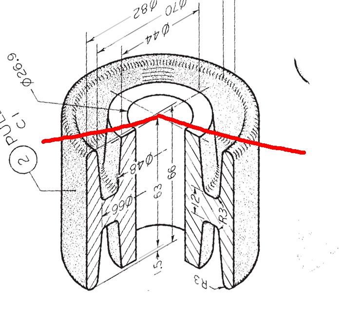

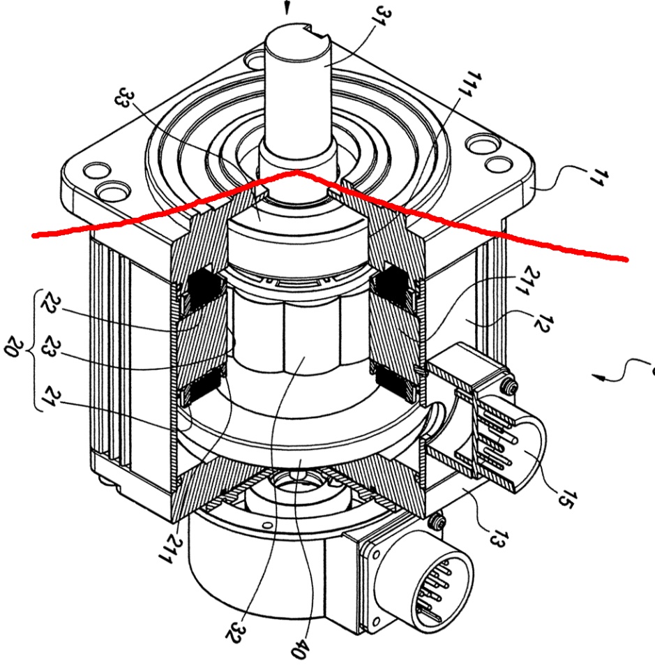

I need an isometric, trimetric, or dimetric section view of an assembly in a drawing similar to images below.
It has to be oriented vertically with a 150 degree cut instead of a 90 degree cut.  I have tried making an isometric section view from a half section view but that has limitations and only seems to work on a 90 degree cut.
I need to exclude some components from being cut like below right.  I realize I could fake it by creating an assembly cut excluding some components then hatching manually in the drawing view but that is... well... faking it and cumbersome.
