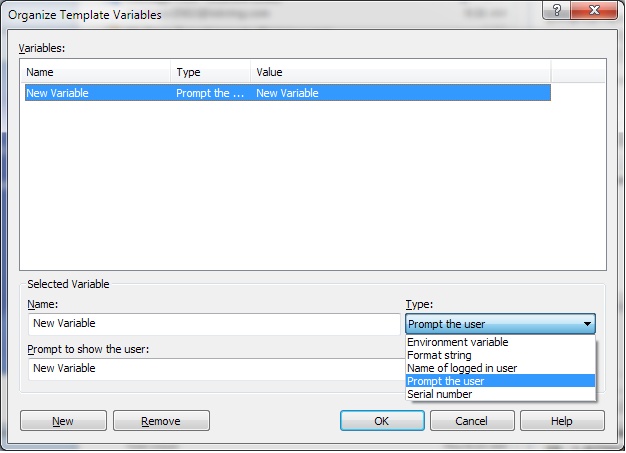

It appears I can only populate TEMP_Score using the following options:
-  Environment variable (can't copy from a data card "X2" variable)
-  Format string (I actually tried copying the input formula here - it crashes windows explorer.  Repeatably.  And it doesn't actually populate the variable with the score.)
-  Name of logged in user (nope)
-  Prompt the user (nope)
-  Serial number (nope)
So to reiterate, what I need is a way to populate the TEMP_Score template variable from the data card (X2) variable T_Score.
