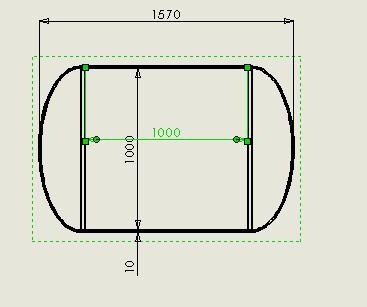

How to convert MathPoint to sketch points
need result is x → 144.594524942555
but follow code result is -1.94494524942556
Helw me
Follow code, How to covert MathPoint  to sketch point ?

MathPoint covert skech point ,resul is error
      Set SwPt2 = SwPt1.MultiplyTransform(SwSketch.ModelToSketchTransform)
