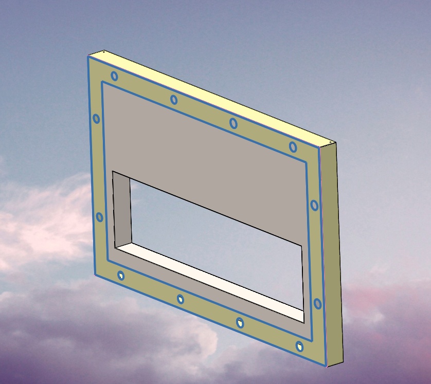

See screencap for reference... this model is to be comprised primarily of two pieces of sheet metal -- the yellow face we see along with the four sides, and the back face we can't see (We won't get in to that inner "frame").  The face we see has a split line rectangle, denoting a line to be etched on the laser.  This is something we do all the time -- what's different and new to me is the modeling method.  We began modeling things as multibody parts, then splitting them out into unique parts.  Unfortunately it seems that to access a flat pattern, once I've saved the individual bodies out, I have to delete the sheet metal feature from the tree and then convert the part to sheet metal.  When doing this, I don't see a way to select the face on the 'inside' of the split line.  Executing the feature then eliminates that entire interior zone.  How do I go about achieving the result I want?

Not exactly sure on what is going on in your example. What do you mean by split line?  Why do you need to convert to sheet metal if it was already modeled as sheet metal?  If it had a sheet metal feature I am assuming that is the case..
Could you post models?  That would help a lot to understand your situation..

We start with a multibody sheet metal part, and then save out the bodies.  When we do this, we can't access our flat patterns, so the workaround is to delete the sheet metal feature and then "recreate" it by converting to sheet metal.  It seems excessive to me, but we're still figuring it all out.  Is there a simpler way?  We need to be able to access the flat pattern feature to set the grain direction, verify that the fixed face is right, etc.
To the first question, we use Insert>Curve>Split Line to create geometry that we want our laser to only etch, rather than cut straight through.

As for your original question...you cannot do it (that I am aware) without getting rid of your split line and then re-adding afterwards.
You can either select the inside of your part.  This will allow you to convert to sheet metal and get the proper geometry you are after, but it will clear our the split line.  The other option would be to use some surface features to get rid of the split line.

I just ran in to this the other day. We regularly use a "Save Bodies" feature on our sheet metal parts to create a parametric separate part that represents the water jet / laser BLANK. The sheet metal features are stripped off and the BLANK part must have a convert to sheet metal feature added back in.
For this particular part, I used a split line to represent an area that would be masked and get no finish. And as you have described the convert to sheet metal feature only has an option to recognize ONE face. The split line feature creates two faces. You can NOT pick both.
In my particular case I just filled in the missing area of the split line by converting entities of the edges. That would not work in your case because of the open window feature in the middle.
A few suggestions as work-arounds:
  • My split line feature was on one side of the part only. In my BLANK part, if I select the opposite face from where the split line is the convert to sheet metal feature grabs the entire face. You just need to extrude in the opposite direction. If you have a split line feature on this opposite face as well this will not work.
  • Instead of using Save Bodies or Insert into New Part, start a new part and Insert Part. This allows you to bring along some of the features of the imported part including sketches. After converting to sheet metal, you would then have access to the sketches that created your split line and other features allowing you to fill in the missing geometry and keeping it parametric by converting entities from those sketches.
