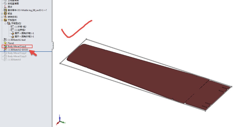

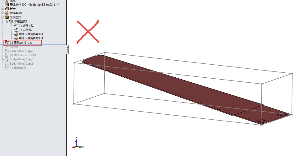

Hi Guys,
I am using this example to create the bouding box of a part, but for the positon of the model , there are many situation , comparing the XYZ datum.
So there will be many bouding box results. How to control to direstion ? May be I can setup a coordinate to the model as the BBX datum.
2014 SOLIDWORKS API Help - Get Part Bounding Box Example (VBA)
when I use move body feature, then the BBX become OK.
