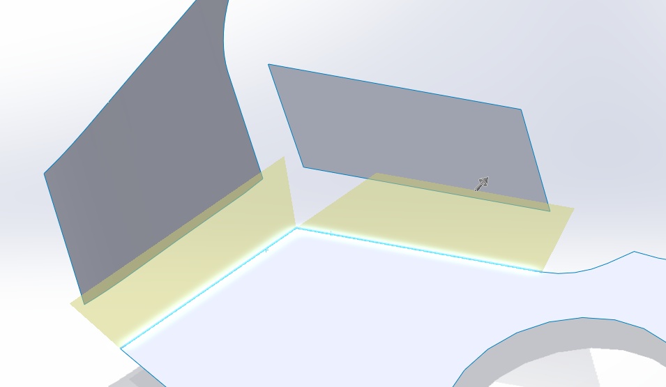

Hello,
I am doing the Surfacing training path in MySolidWorks.
The idea is to repair a STEP file that that is not fully correct.
I am trying to reproduce the steps given in the following video, 'Presentation 2', @3:15: https://my.solidworks.com/training/master/283
Best is to get the file directly from the training and make an offset at 0 m of the large surface, then hide the 'imported' feature:
Basically, their are doing an Extend Surface, and it works instantly, extending also in the corners:
However, in my case, if I take the raw part, I cannot:

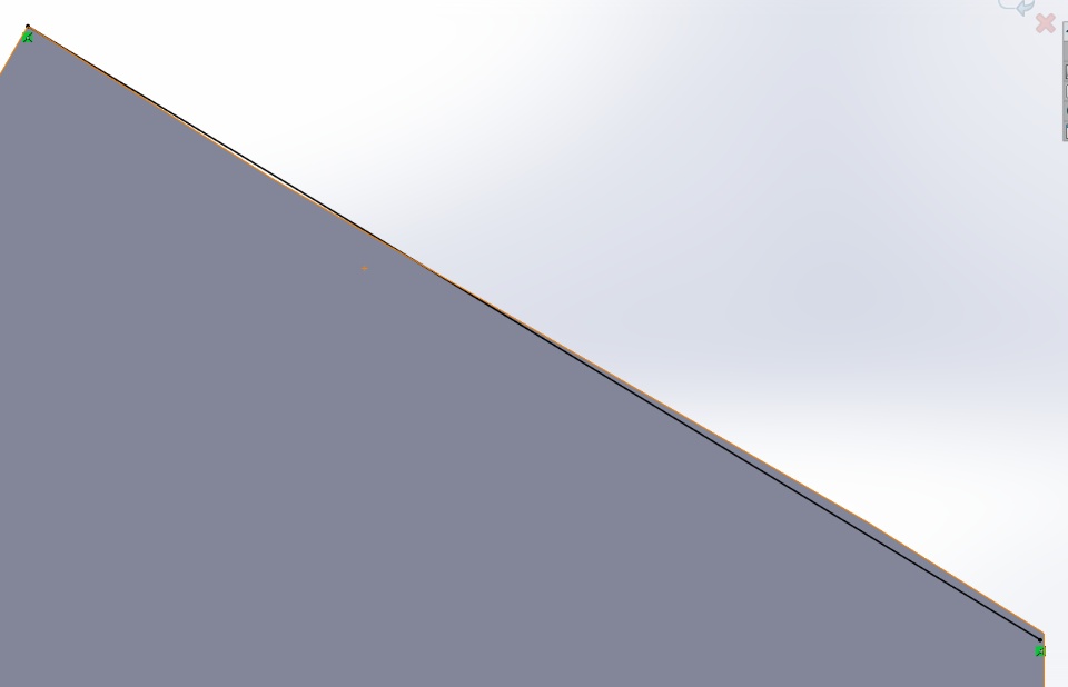

I get why, the blue edge on the left is not a straight line, but rather something wavy.
(Why is the right point marking intersect, but not on the edge? The view is normal to the surface, which is a plane.)

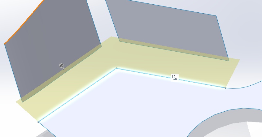

So, I did an extend, then a trim using a sketch line:
I have my straight line.
I do not have an extend in the corner:
The other line looks good visually, but I tried the same thing just in case: extend then trim
Now, I can extend!
