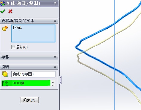

i want to Reset the value of rotate angle of move /copy feature by API ,while i failed. the feature is show below
Sub main()
Set Part = swApp.ActiveDoc
Set moveCopyFeat = Part.FeatureByName("实体-移动/复制1")
  Set moveCopy_featData = moveCopyFeat.GetDefinition
copycount = moveCopy_featData.GetBodiesCount
boolstatus = Part.EditRebuild3()
Part.ClearSelection2 True
End Sub
in fact ,i don't know how to find the parameters in features.usually ,i use macro-recorder to get the relevant parameters and then change the value .while as to these parameters in features, while i use macro recorder to modify them ,the modifying process couldn't be recorded in the macro file which lead to my difficulties to change these parameters .so anyone can teach me how the change these parameters in features .
many thanks!!
