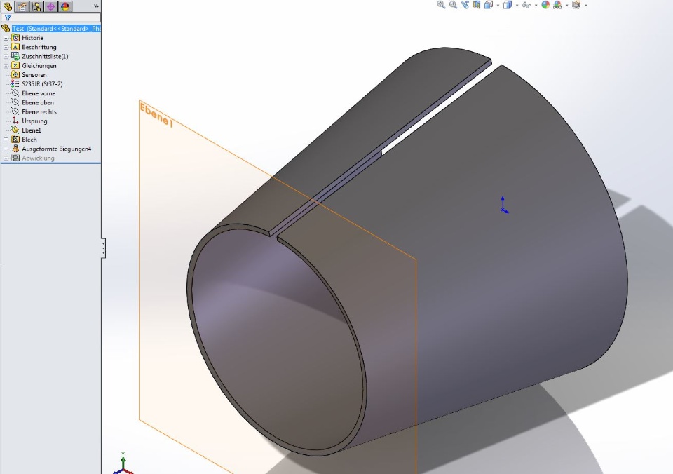

How to built a widening with API; InsertSheetMetalLoftedBend2
Hi I'm Christian and I try to make a Makro in C# for a widening.
my code so far:
IModelDoc2 modDoc = (IModelDoc2)iSwApp.NewDocument(partTemplate, (int)swDwgPaperSizes_e.swDwgPaperA2size, 0.0, 0.0);
                modDoc.Extension.SaveAs("Test.sldprt", 0, 1, null, 0, 0);
                //Insert Sketch
                modDoc.InsertSketch2(true);
                modDoc.SketchManager.CreateArc(0, 0, 0, 0, iD/1000/2 , 0, Math.Sin(355 * Math.PI / 180) * iD/2 / 1000, (-iD / 2 / 1000 + Math.Cos(355* Math.PI / 180) * iD / 2) / 1000, 0, -1);
                // second Sketch on a Plane
                modDoc.InsertSketch2(false);
                modDoc.ClearSelection2(true);
                modDoc.Extension.SelectByID2("Ebene vorne", "PLANE", 0, 0, 0, false, 0, null, 0);
                modDoc.FeatureManager.InsertRefPlane(8, L/1000, 0, 0, 0, 0);
                modDoc.Extension.SelectByID2("Ebene1", "PLANE", 0, 0, 0, false, 0, null, 0);
                modDoc.SketchManager.CreateArc(0, 0, 0, 0, aD/2/1000, 0, Math.Sin(355 * Math.PI / 180) * aD / 2 / 1000, (-aD / 2 / 1000 + Math.Cos(355 * Math.PI / 180) * aD / 2) / 1000, 0, -1);
                modDoc.Extension.SelectByID2("Skizze1", "SKETCH", 0, 0, 0, false, 1, null, 0);
                modDoc.Extension.SelectByID2("Skizze2", "SKETCH", 0, 0, 0, true, 1, null, 0);
                //create sheet feature
                modDoc.FeatureManager.InsertSheetMetalLoftedBend2(1, t/1000, true, 0 , false, 0, 0, 0, 0, 0);
the code does everything I want exept creating the Feature. Did i made a mistake?
In the end it should look like the attached picture
