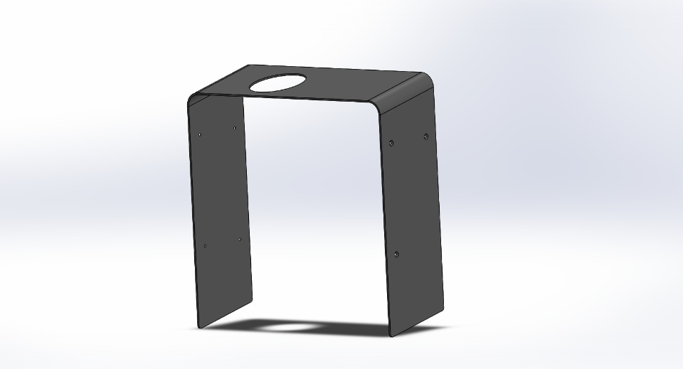

I'm working on a metalsheet project with a 20mm bend radius which is bend in an angle:
The only problem is that the real life prototype is not quite as neat as the sw model.

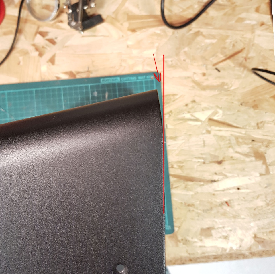

I'm experiencing 2 problems:
1) Quite a big shift/gap:

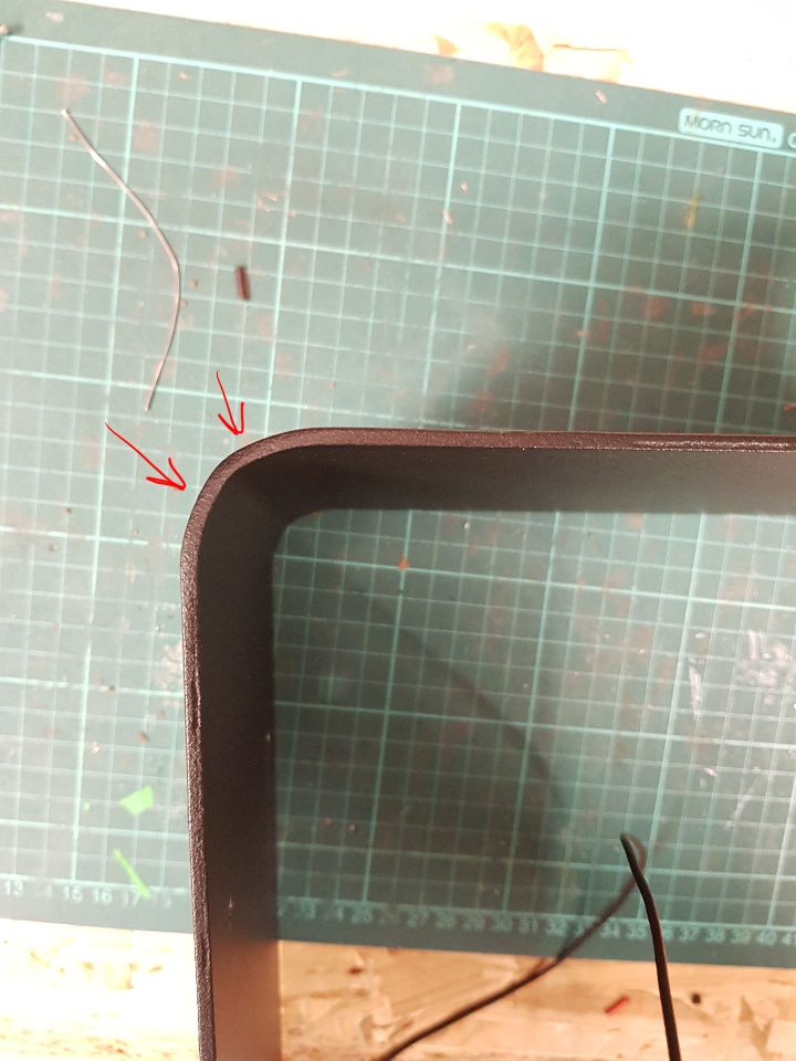

2) Corner is not nicely curved (maybe this has to do with the punching machine instead of laser cutting the flat pattern)
Does anyone have a suggestion how to solve either of the 2 problems? Obviously I could try to add a bit of extra material on one side and extract on the other side in the flat-pattern, but this feels like a last resort solution for problem 1.
