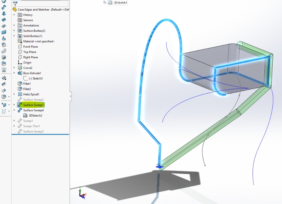

This part has several sweeps.
Sweep1 path is a combination of a 3D sketch and edges of a body.
I can access to the Skecth querying the path, but not the edges.
Attached the part and the macro.
Macro allows preselection.
SolidworksApi/macros
