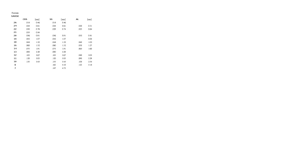

We design in millimeters and use sheet metal gauges currently common in the US. For our sheet metal models, it is my preference to model a sheet metal thickness to the nearest tenth of a millimeter for the thicker gauges, to the hundreth for thinner stuff. I keep the model thickness inside the thickness tolerance. I might try to hit on the low side, since most sheet metal runs light.
I prefer to do this to keep the part dimensions easy. You can't always design on one side of the sheet - many times the thickness gets into the part dimensions.
Others in our department prefer to use the 3-place inch value shown in the charts and convert that to millimeters, no matter how many decimal places produces. Still others, more middle-of-the-road, prefer a millimeter value to two places as shown in some gauge charts.
