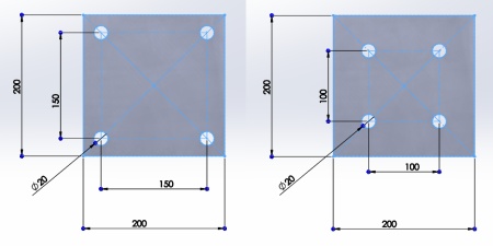

Unfortunately this information is not enough to uniquely identify a body (I think). For example, I could make 2 base plates with the same dimensions but put the mounting holes in different places.
