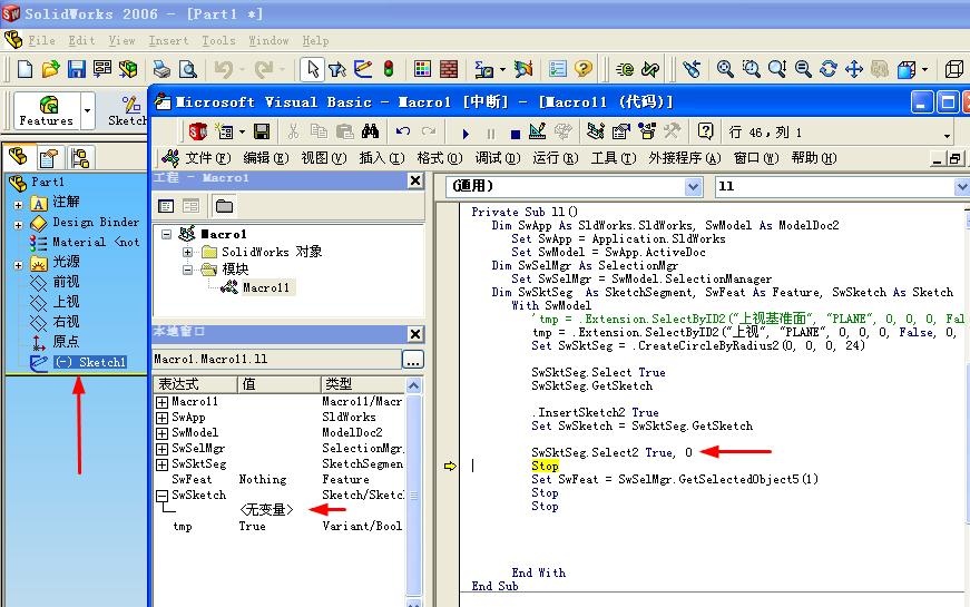

How get feature name in create circle.
follow code.
         SwSktSeg.Select2 True, 0 →  can be select
         Set SwFeat = SwSelMgr.GetSelectedObject5(1) → don't set SwFeat
Private Sub ll()
   Dim SwApp As SldWorks.SldWorks, SwModel As ModelDoc2
      Set SwApp = Application.SldWorks
      Set SwModel = SwApp.ActiveDoc
   Dim SwSelMgr As SelectionMgr
      Set SwSelMgr = SwModel.SelectionManager
   Dim SwSktSeg  As SketchSegment, SwFeat As Feature, SwSketch As Sketch
      With SwModel
         'tmp = .Extension.SelectByID2("上视基准面", "PLANE", 0, 0, 0, False, 0, Nothing, 0)
         tmp = .Extension.SelectByID2("上视", "PLANE", 0, 0, 0, False, 0, Nothing, 0)
         Set SwSktSeg = .CreateCircleByRadius2(0, 0, 0, 24)
         SwSktSeg.Select True
         SwSktSeg.GetSketch
         .InsertSketch2 True
         Set SwSketch = SwSktSeg.GetSketch
         Stop
      End With
End Sub
