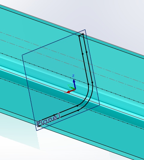

I am trying to write a macro which will place a sketch point at the centroid of a section. The code is below. To use it create a closed section on a 2D sketch plane and measure the section properties. Then execute the macro.
The macro works, but the problem is the point it places is not exactly at the same coordinates as the centroid of the section. The code prints out in an Immediate Window with the coordinates. These are correct. The point it places, however, is not at these coordinates.
Example, here is a section:

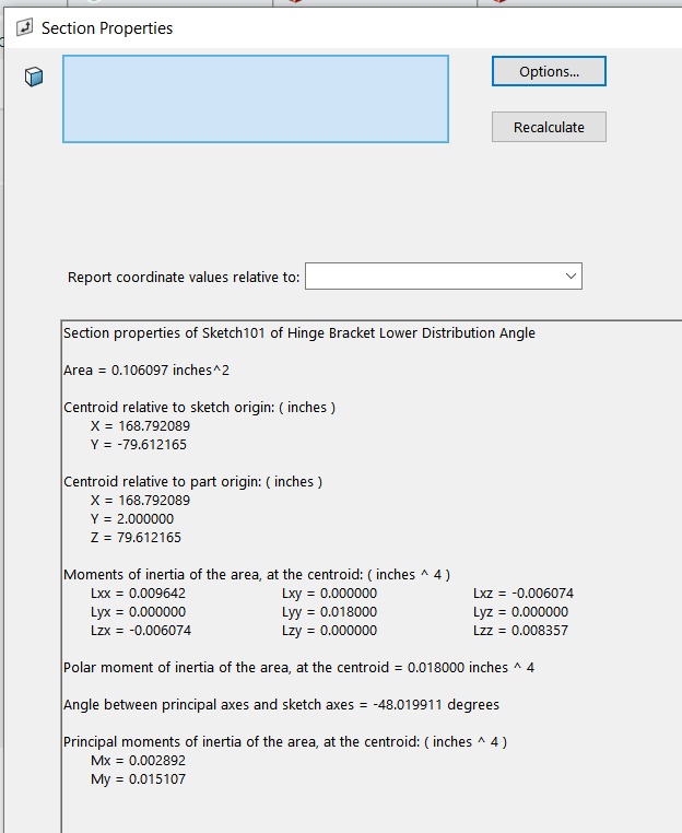

Here is the results of "Evaluate->Section Properties":

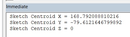

Here is the results in the Immediate Window after running the macro:
Note the coordinate are correct to within six decimal places.

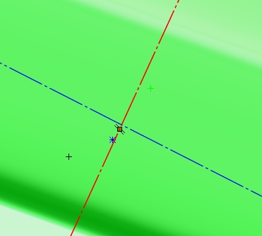

Here is the display after the macro is run:

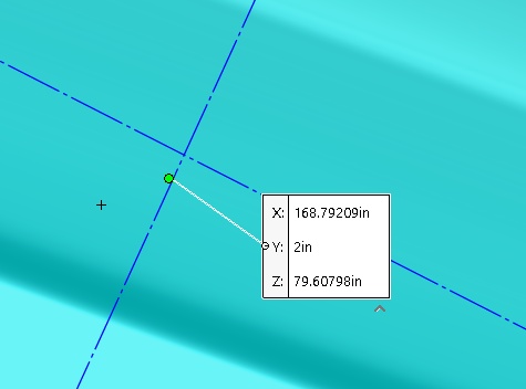

Here is where Solidworks says that new point is:
Note the X value is right on, but the Z value is off.

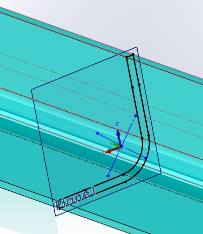

As a secondary problem the midpoint of those two lines do not line up with the sketch point, even though they are both created with that point being in the center.
And...
