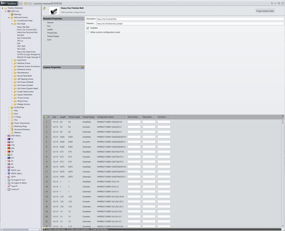

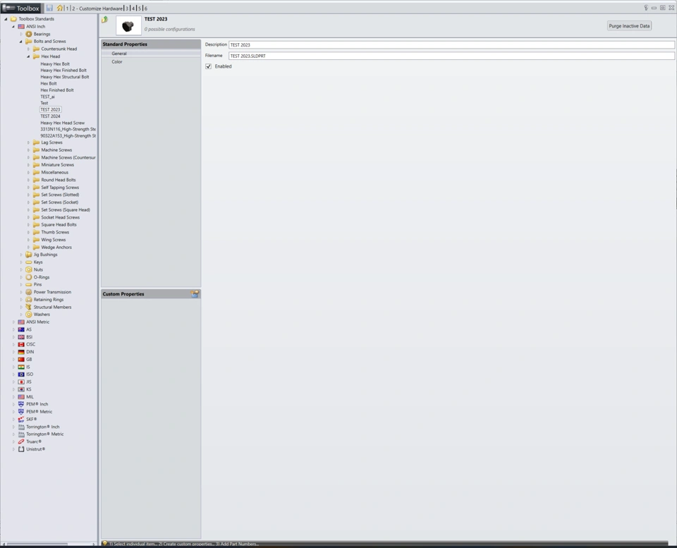

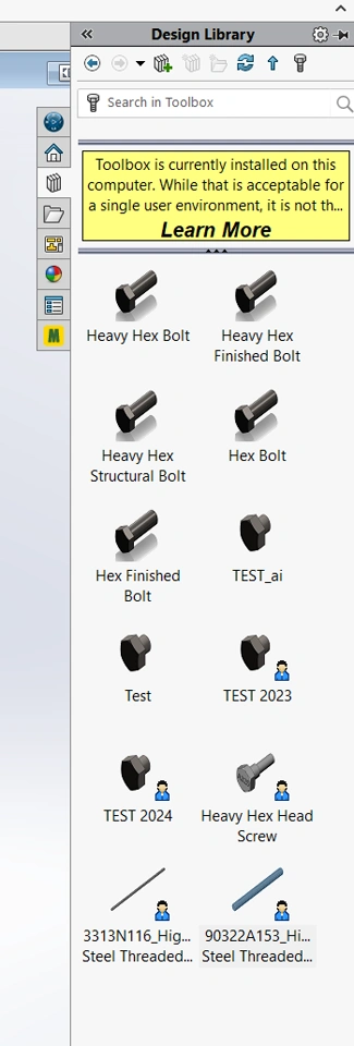

Just for clarification, below are screenshots of toolbox standard parts vs. parts that I copied from toolbox standard parts vs. parts that I made and imported into the design library. As you can see Heavy Hex Bolt lacks any indicator. Test_ai is a copied part that also lacks an indicator and has the same file format and configuration as a standard toolbox part. TEST 2023 and TEST 2024 are parts that I imported into the toolbox and are denoted with a little indicator. These parts do not have the configuration or format of the naitive toolbox fasteners.
These are screen shots of standard toolbox fastener configurations(A) vs parts that I make or download (B). I am trying to get my parts
To be formatted the same as the standard toolbox fasteners because those will populate the smart fastener library.
