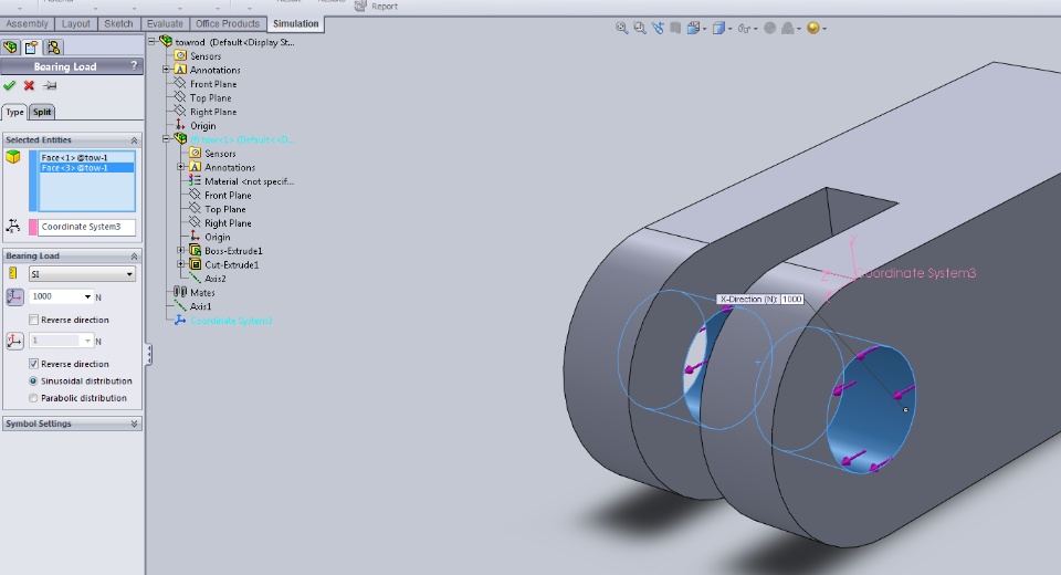

I was wondering how I can actually go about applying a bearing load in Solidworks Simulation. This is a much simplified case of what I am trying to accomplish and it basically comes down to a pin and fork. I am getting the error "Bearing Load requires te selection of a coordinate system and a set of cylindrial faces of same radii and the Z-axis of the coordinate system must be coincident with the axis of the cylindrical faces" whenever I try to add a bearing load.
As I read that:
1) Coordinates system with Z-axis coincident with the axis of the cylindrical faces.

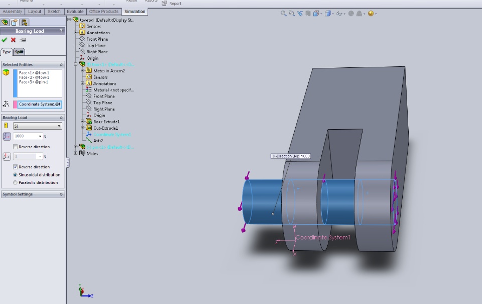

I am not sure what it means make the Z-axis coincident with the axis of the cylindrical faces. As you can see in the picture above it is parallel to the axis and I have been able to make that coordinate system coincident to points, but I have yet to be able to figure out how to make it coincident with the center of the pin as there are no points there (that is, just a face. Or in the case where I remove the pin there is nothing but the bore, the axis seems to be unselectable as a vertex for the coordinate system position).
2) Set of cylindrical faces of the same radii.
I am assuming this means without the pin (since due to tolerances it will not be the same radius as the bore on the fork). With the pin in I selected the outer face of the pin and the two faces made by the bore. Without the pin I just selected the bore faces.
I have tried just about every combination I can think of, I have no idea how to get past this error to set a bearing load.
