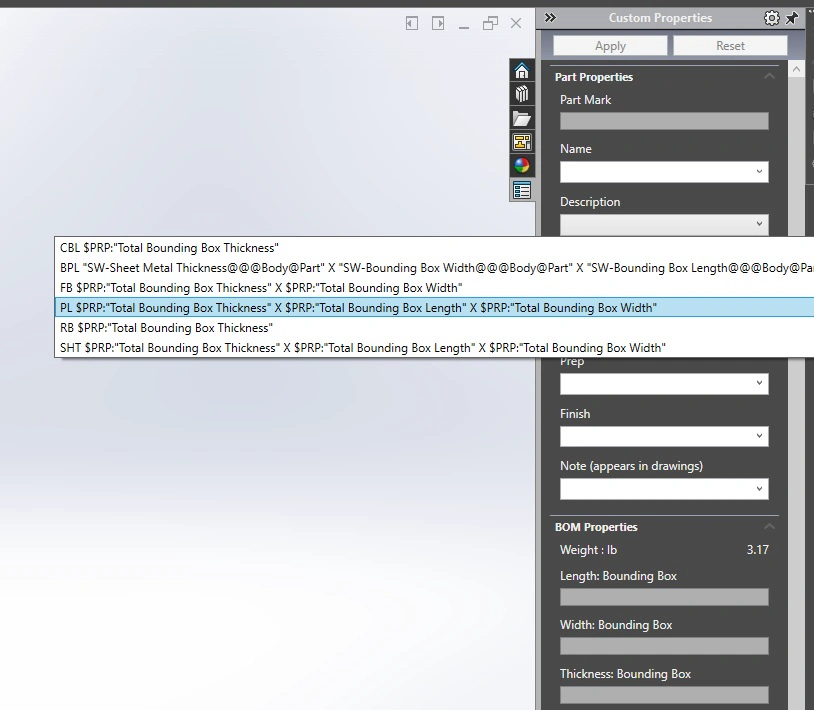

How do I pull a property from the cut-list layer, to the part file layer?

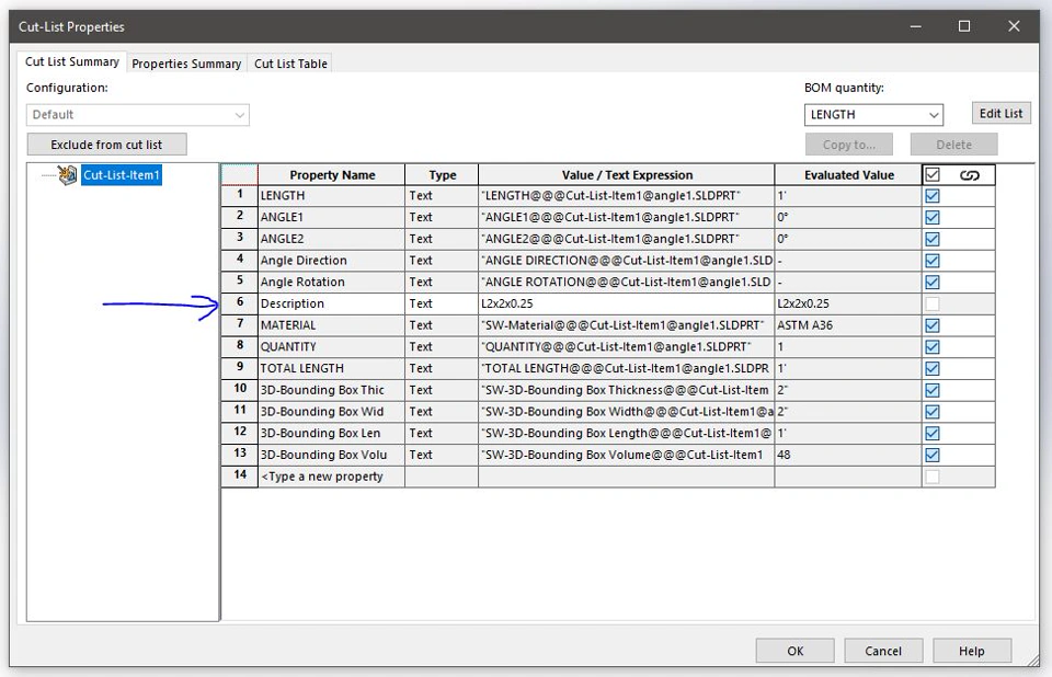

I am trying to figure out how to get "Description" from the cut-list (item 1) and populate it to be the part files description. The cut-list "Description" property comes from my weldment profile.
My goal is to be able to create a part with a single weldment feature (beam, pipe, angle, HSS, etc) and choose a description method from a drop down menu in Custom Properties side bar and have the property pulled from the first cut-list item, which is the only cut-list item in most cases.
