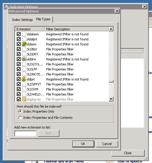

I wish to have our server create an index of our SolidWorks files.  However, I have been unable to get the SolidWorks iFilters installed:
I have installed SolidWorks Explorer, and it is functional except for searching: searching for a configuration name yields no results.
I am certain that the search paths are setup correctly so that the location where the SolidWorks files are stored is being indexed.
How do I install the SolidWorks iFilters?  I expected them to be installed when I installed SolidWorks Explorer, but no luck.
