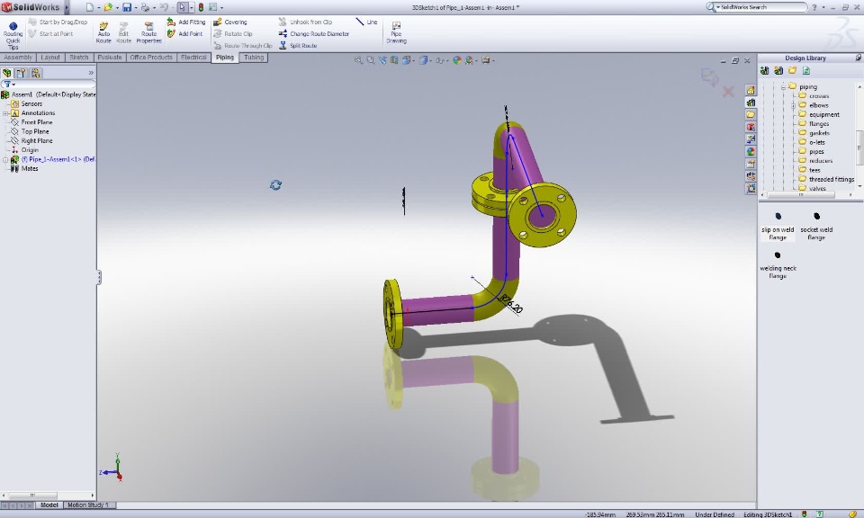

Insert flange of 1" in new document. Start new route - give route property - pipe and elbow.

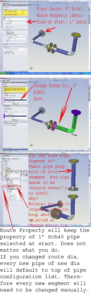

Given property will be aplicable only for 1" pipes and elbows. If the pipe dia change (chance of this happening is 99% - Mr. Andy H. - This fact I announce specificly for your attention!) the route property will be defaulted to the top of configuration list.

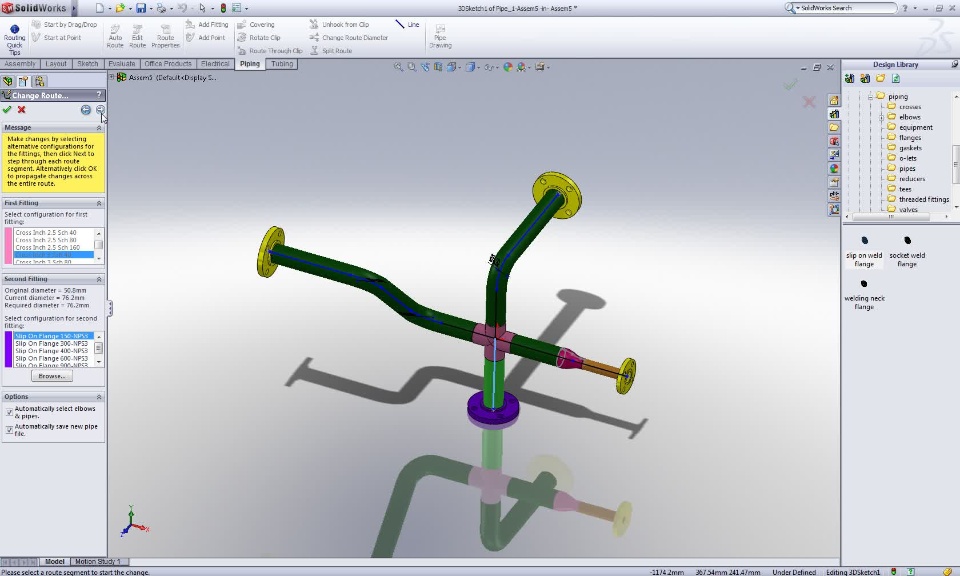

Question: HOW DO WE CONTROL THE ROUTE PROPERTY FOR SIZES THAT ARE DIFFERENT from size specified at start? I am not asking to go and correct manually "Route Segment Properties" for each segment. I am asking about controling property for entire route.
Sample: I route 1/2" dia, say I want all the piping to be threaded sch 80, then I route 2" line, I want from here go Butt Weld Sch 10.
