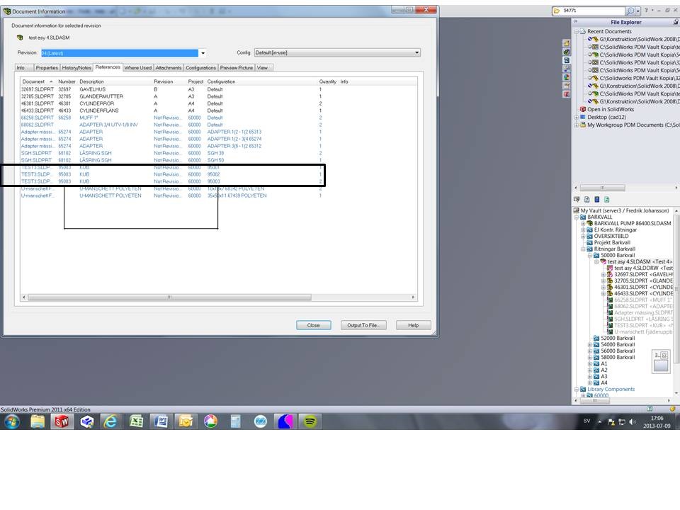

How do I change column Number on Library Components if I have configuration on it and it's included in assembly? This is when you right click on a assembly in the Vault (Workgroup PDM) and show Document Information and select References and select Config: Default [in use] SW will not change column Number to right number that I have in specific configuration.
When I use the BOM-list in the drawing it takes correct number that I have configured.
See picture below
