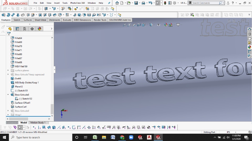

How do I add text to a curved surface and add draft for injection molding?
If you look in the design tree, you can see i extruded the test and then used an offset plane to cut .030 from surface. I've had no success with the draft feature.
