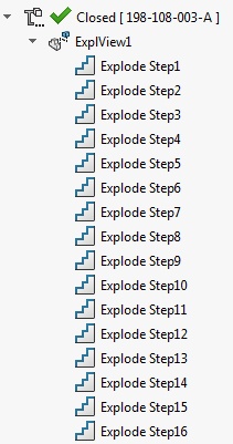

I currently have all the explode steps under a single explode view because I do not need to show the intermediate steps.  Is there a possibility this results in somesort of inaccuracy in where SolidWorks thinks the parts are on the drawing sheet?
