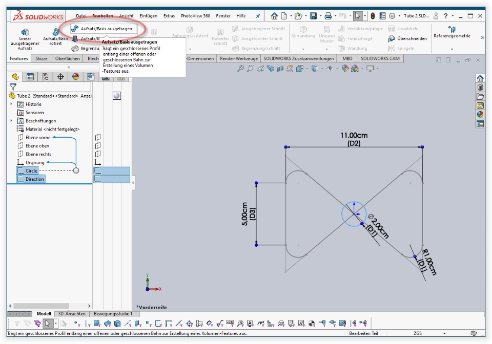

So, when I was trying to do the same on SolidWorks, I first unsuccessfully tried to create a part just like I did using Maxon Cinema 4D, consisting of one sketch depicting an infinite loop, another sketch depicting a circle, and applying a Sweep feature to both of them:
The sketch depicting the infinite loop wasn't recognized as a filled object, so the Sweep feature couldn't be applied.
So, I next tried to create just half of a loop using the same approach. I believe that I'd be able to join four of these loops appropriately in the end.
But this time I'm not able to have the Sweep feature generate a smooth junction between the polygon and the arc (see red highlight):
I'm stuck. What am I doing wrong?
