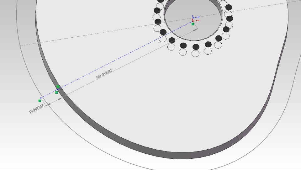

We created a cam by generating points in Excel.
The points are then used to create a XYZ curve.
This is extruded to an initial plank.
A circular cutter is drawn with the center on the curve.
A sweep of the cutter creates the cam.

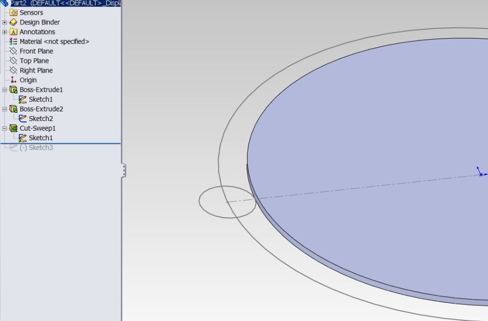

We have a problem with the accuracy of this process.

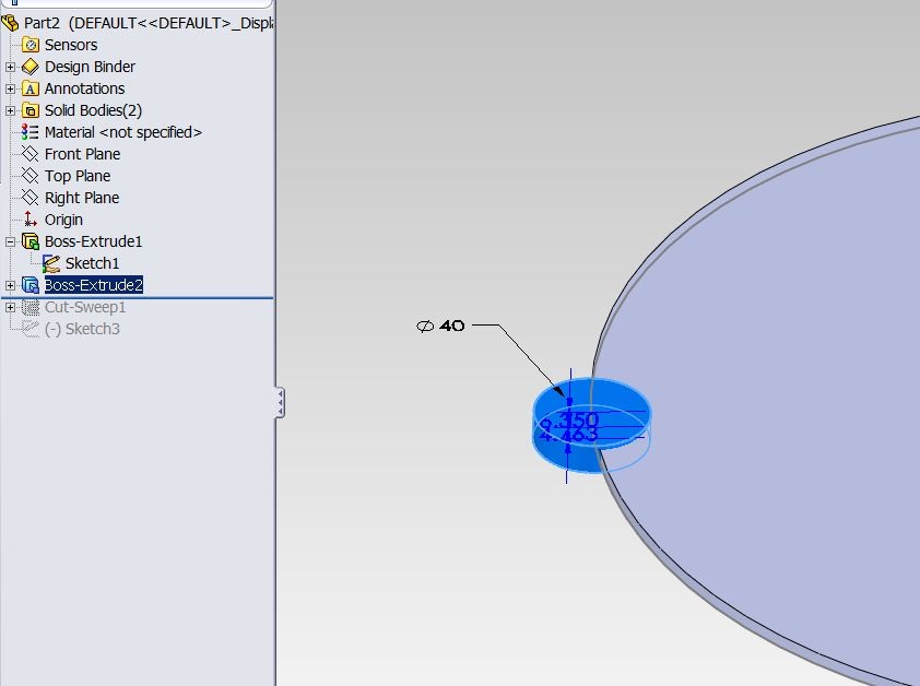

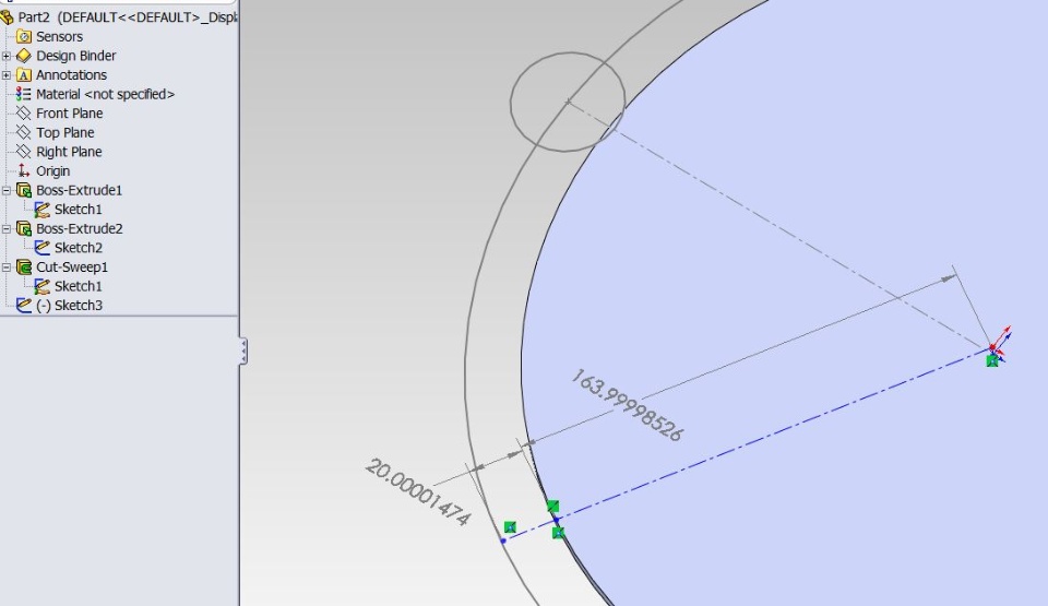

A 40mm dia cutter cuts 19.9877.  The interesting thing is it's not a consistent error.

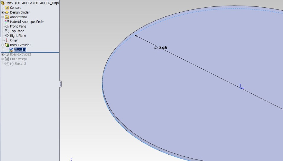

I've simplified the process using a circle as a path and a circle as a blank.
The resaulting body shows a similar inconsistent error.  The final body isn't round.
What should the process be?
