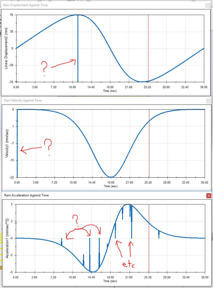

I have created the simplified model pictured below and set up a motion analysis study in order to drive the system at a constant velocity of 10 deg/s and plot the displacment, velocity and acceleration of the ram.
When setting contact between the driving parts I set friction to zero because I am wanting to create a "perfect world" simulation where not external forces apply and no deformation takes place etc. That way it can be compared directly to my mathematical analysis
However, the problem I am having is when I come to plot the graphs they all seem to be affected by "noise", please see the picture below:
I have attached a zipped folder of all my files and the assembly file I've been working in, I'm really stuck for ideas on how to remove the noise from the graphs as I dont know whats causing it, if anyone knows how I can sort these graphs out I would REALLY appreciate it.
