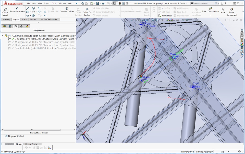

I'm trying to simulate how a hose would actually move.  The hose will be attached at these two points shown below:
So, I tried at 0, 45 and 90 degrees, but it broke.  There's also a Free to Rotate configuration.
Obviously it'll be difficult to perfectly simulate because bend radius and droop will have to be estimated.  But, I'm curious what possible solutions there are for this situation.

The most difficult part will be to get the length to stay constant.
You could create a line and define the length of that line, then use a spline with some defined spline points (like the ends and then maybe 2 points near each end), but leave the center area free to move as needed.  Then use an Equal Curve length constraint and make it equal to the length of the line.

So the attached file shows what I gathered there and sizing & positioning from what I could capture. I've only modeled the moving pieces as we're after hose that moves with the bridge angle action. Clearance for this to your structure is on your shoulders.
I have the 2 cylinders there w/hose fitting, the manifold where the opposite end of the hose connects, and 2 hoses which are the same length but different color or shapes and part files for this unique hose bend purpose. The 0deg really isn't 0deg, it's 0.01deg cause of design table config. You should be able to edit the hose spline lengths & their weighting on each end of the spline (currently equal length handles or control lines).
You should be able to insert this into your assy about the origin of this assy file centered onto your bridge pivot axis to see how it goes.

This kind of helps, but still at a loss, the bridge or structure masks or covers up a lot visually from the underlying hose/cylinder problem area we need to focus on.
It looks like the bridge or structure rotates CCW for each config click there. It looks like both cylinders stay "parallelish" to each other, their position to each other isn't changing. Beyond this I can't see or make out anything else that will allow any action item to proceed.
I think breaking this down into 2 categories is a good place to start. One is what is a us type problem. This is getting the hose to behave as it typically would in the real world with motion applied to it. This is something that can be simplified from your above model. We just need to know what the hose connects to on each and and in which orientation and position, and how these 2 parts are each end of the hose are to move and in which range. So if a simple model, sketch can be used to hash this out then I think it's best to start simple here.
This is a movable bridge.  All of the steel is attached to the structure (the bridge) which rotates 90 degrees.  In the video it starts at the 0 degree position, goes to the 45 degree position and then to the 90.  I did that to show range of motion.  In the asm there's also a config with the degree position mate suppressed to be able to freely move the bridge between those points.
The cylinders, for the most part do remain parallel, and since the blind end of the cylinders is attached to the structure the hose connections stay relatively close to the center.  The rod ends of the cylinders attach to the pier.  I show the cylinders as a simplified cylinder and didn't bother dropping in the real parts because that'd clutter things even more.
I have attached an edrawing.  You should be able to download the edrawing reader for free for 2019 or 2020 to be able to open it.  Once you get a chance to click on the configs and rotate the model, you'll be able to see what's going on a lot better.

Your files are a future version to me, I cannot open for this reason. Can you show, describe, or illustrate simply with just the MIN required items what this is? I'm not getting it all from that 1 image. Or save it all out as a step file (maybe just the MIN items) and some description of what mates need to be added and in which way to which piece?
Like Matt said, a spline with a length dim will be needed, also some ref geometry whether is existing or new will be needed and there are many ways to establish this. In addition what comes to my mind is a virtual part in the assembly, which will probably need a rebuild click after each position move or change to update the hose.
Absolutely, this is how it'll have to be done.  You'll move the bridge and then CTRL-B to have the hose update.  If you've ever done one of those springs with blocks that updates after the blocks are moved, it'll have to very similar to that.

The power unit is attached to the structure that rotates as the bridge opens.  There is a manifold attached to the structure where the hose needs to attach.  I located that as close to the center as practical.
The cylinders are attached to the pier and are used in a push-pull arrangement to open the bridge.  So the hoses need to go down to the cylinders.
I hope that clarifies the situation.
Unfortunately, I don't know if step files will help without an assembly with mates. I may be able to save out to parasolid and open on a version with 2014...I'll see if I can get to that today.

You can define the path length and set it constant for a spline...That part isn't the hardest, for me.  My hardest part is to get construction geometry or something to have the 3D sketch relations to track upon...And to have the spline "behave" during the motion.
I think it's an interesting exercise and I'm curious what people come up with.
