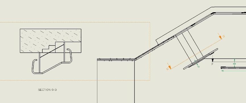

When showing a section view that is on an angle on the parent view, the resultant view is also generated on that angle to be aligned. But I want this view to be vertical, so I pick a horizontal edge, then go tools>align drawing view>horizontal edge. This rotates the view so it is now horizontal, but it is 180degrees from where it should be!!
Nowt I can do fixes it - I've tried on all the horizontal and vertical edges in the view.
