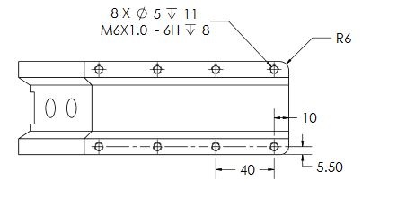

Im new to solid works and am having trouble getting the desired dimensions. I don't understand how to get the H in M6X1.0-6H depth 8. I will attach images of what i need and what i can only get.

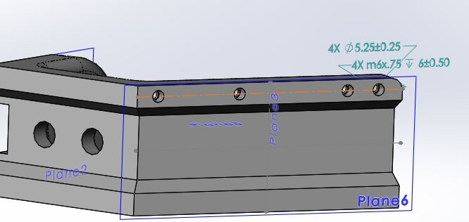

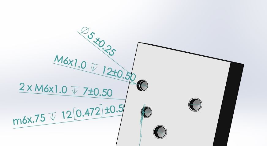

This is what i get how do i get the depth and what does the ''H" signify?
A few attempts but no success. I would appreciate any help.
