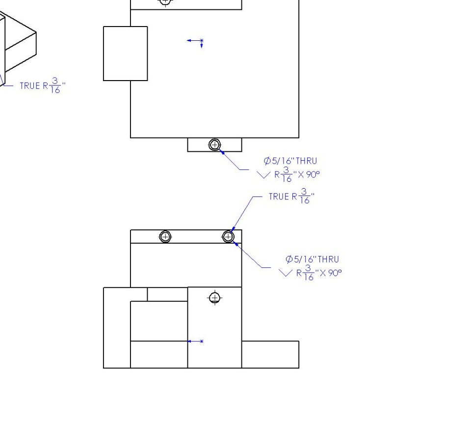

I seem to remember in our training class that if a threaded holehas been created in a model using the hole wizard, that the holeinformation can be automatically shown in a drawing.
However, that does not seem to be working.
All I get is the hole diameter or the countersink diameter.
At no point in the past 2 hours have I been able to have it displayany thread information at all.
Is this just a user error, or is this another issue that will befixed in the next service pack?SolidworksDrawings And Detailing
